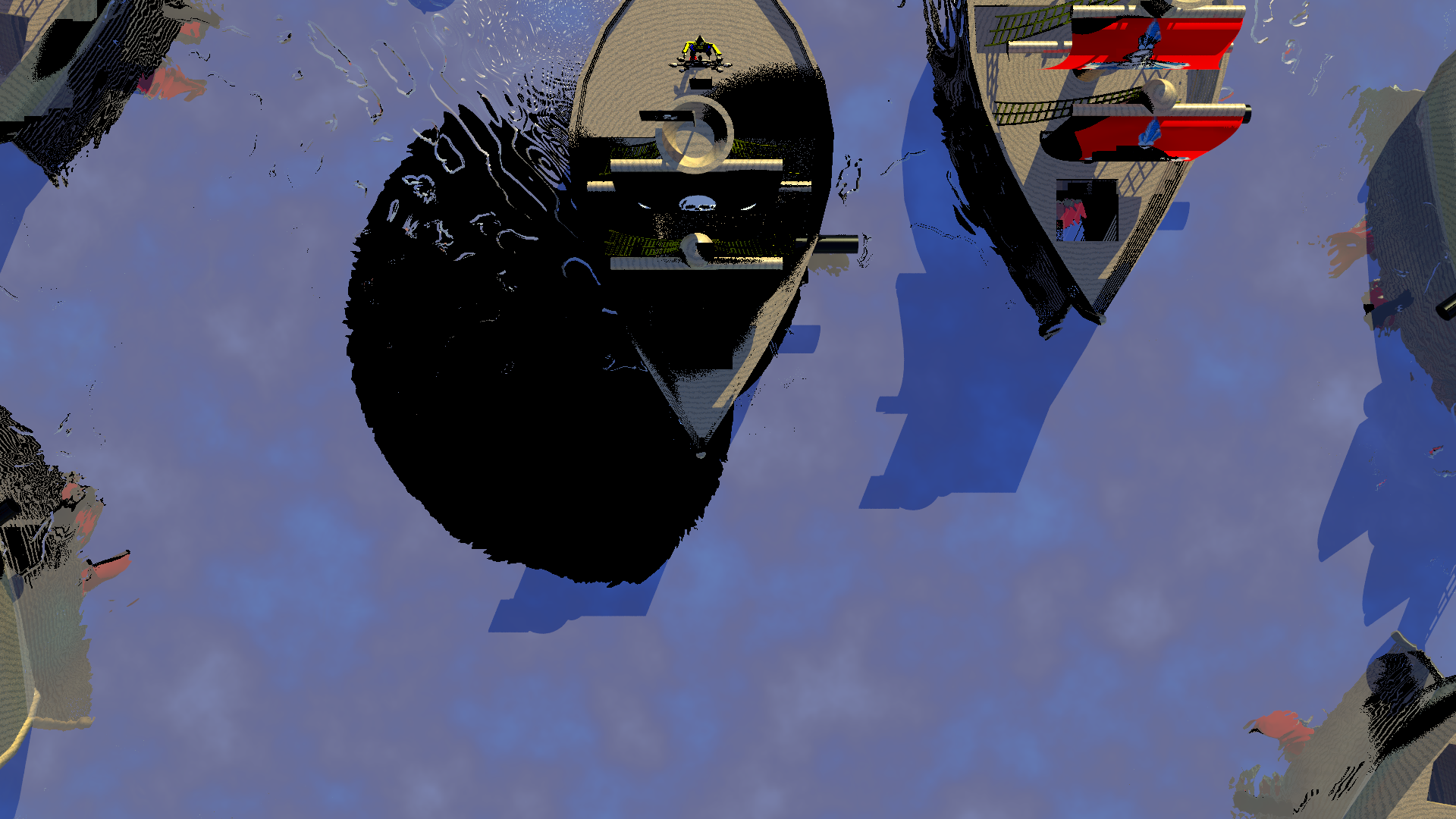

Recently, I have been rendering an animation with POV-Ray 3.7 RC 6 using radiosity, photons and backside illumination. Many frames contained artefacts like in the attached image file. Trying to eliminate those artefacts I observed the following:
- Rendering the same frame several times did not reproduce the artefacts or reproduced them differently. I.e., when I rendered a second (third, fourth, ...) time with +SF100 +EF100, the black space in the image was somewhere else or in some cases disappeared.
- With radiosity turned off, no such artefacts have happened since, even in the scenes where they happened with radiosity turned on.
- Turning off photons with radiosity still turned on did not remove the artefacts.
- Rendering with one thread on one CPU core instead of two threads on two cores did not change anything except the rendering time.
- Changing the radiosity settings I have not tried thoroughly, but at least raising or lowering count or error_bound does not seem to have any effect on this.
While POV-Ray was rendering, no other memory-intensive or CPU-intensive programs were running and POV-Ray itself did not report any error (just the usual warnings that some of the used features could change in future versions etc.). Render priotity was set to “high”.

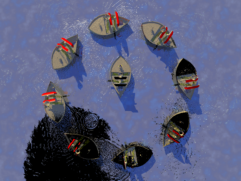

Here you are.
I have removed animation code (usages of the clock variable) and the ships' sails' image maps. (As the attached image shows, I still get an artefact.)
Does this happen with every render ... how repeatable is it? I ran (2 dozen times) your min scene and never got the black artifacts even once. Exception of the black cannons and the back side of the sail in the middle of the ring of ships. I /did/ however get just /once/ strange results between the ships at 5 and 6 o'clock position, however the artifacts were /white/ not black

I cannot precisely state how repeatable those artefacts are. In some of the animation scenes, I observed them nearly every other frame and re-rendering individual frames produced artefacts again (usually not the same, but similar), in other scenes hardly any artefacts occured or artefacts were not produced when re-rendering a frame. (I just took scene 15 as a sample.)
However, all scenes, regardless whether artefacts occured or not, use similar (low) radiosity counts (below 10) and similar photons spacing. Admittedly the photons options can cause the scene to look speckled, but turning off photons did not remove the artefacts, i.e. I also observed them in scenes rendered with photons being deactivated.
Yet I have tried raising radiosity count, not in all scenes, but in those which showed artefacts. I thought that would solve the problem, but it did not. It just slowed down the render. The artefacts did not vanish.
Since you seem to be unable to reproduce the effect (or just get white instead of black artefacts), do you think it is a problem related to my hardware or operating system, respectively?
I did manage to reproduce the artifacts you are reporting; I haven't found out what they actually are though. Somehow radiosity seems to gather "negative" or "illegal" light from somewhere.

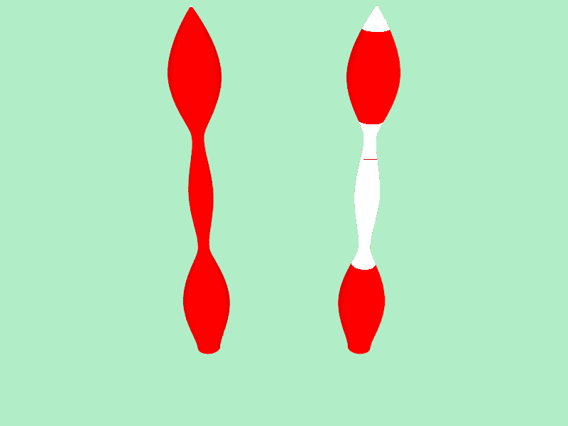

After dramatically trimming down the scene I was able to nail down the artifacts to the "Radius" object in the scene; apparently we have a bug in the sor code.
For discussion sack:
#local Radius = sor { 9, <0.01,-0.1>, <0.01,0>, <0.02,0.05>, <0.005,0.1>, <0.01,0.15>, <0.005,0.2>, <0.02,0.25>, <0,0.3>, <0, 0.35> sturm }N-A-N might be due to -ffast-math (IIRC, that removes checks and computes anyway), without it I would expect a kind of exception/crash.

Illustration with the original Radius (on left): texturing is bogus; With a scaled radius, it's better until the the top of the object is reached.
967353 might be: when X²+Z² =< DEPTH_TOLERANCE, N remains unset on curve.
(circa line 604 of sor.cpp)
967356 is about superellipsoid, no cigar.
(My bet is on CID:967353, usual amount: N-A-N on Sor::Normal... )
Without correcting CID:967353, replacing >DEPTH_TOLERANCE with >0 seems to be ok in sor.cpp. It produces a far better texturing of the sor in sor.pov;
The test >0 seems fine with the underlying maths in the "then" sections, does anyone see a reason to need DEPTH_TOLERANCE ?
I do not know how to handle the case X²+Z² == 0 (which N would you use ? with a bit of luck, it never happens, especially due to numerical precision and antialiasing, if any ?)
CID:967353 is a hot candidate; I'll try what happens when I fix it.
In the case of X²+Z² == 0 we'll get a normal facing +Y or -Y, depending on what direction the local slope happens to be biased towards.
A zero slopele can only occur at a single point in space, or with a truly pathological construction.
Yup, CID:967353 was the bad guy. Dropping the test altogether solves the issue.
