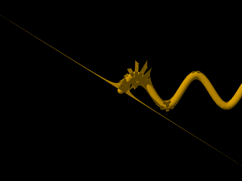

FS#92 - Sphere_Sweep Bug
This item may need to be merged with item FS#81. This is another sphere sweep bug, though they are of different spline types.
The code is
#include "colors.inc"
camera {
  location  <0, 0.0, -4.0>
  direction 1.5*z
  right     x*image_width/image_height
  look_at   <0.0, 0.0,  0.0>
light_source {
  <0, 0, 0>            // light's position (translated below)
  color rgb <1, 1, 1>  // light's color
  translate <-30, 30, -30>
#declare i_start = 0;
#declare i_stop = 3;
#declare i_step = 0.05;
#declare i_inc = i_start;
sphere_sweep {
  linear_spline                 // linear curve
  (i_stop - i_start)/i_step + 1,    // number of specified sphere positions
#while(i_inc<=i_stop)
  #declare y_coor = 0.23*sin(7.1*i_inc);
  <i_inc, y_coor, 0>, 0.05
        #declare i_inc = i_inc + i_step;
#end
pigment{color Orange}

Sorry, posted wrong category. Also, did not know how to display image.
Under some circumstances (apparently when the camera is close to the plane perpendicular to the spline, and sufficiently far away), the coefficients of the quadratic polynom to solve grow seriously small, causing some approximation mechanism in the root solver to kick in where it’s not helpful.
The issue seems easy to fix, but I’m not sure yet whether to modify only the spline code or the root solver as such (the latter will obviously affect other geometry for good or for bad).
fixed with change #4944.
