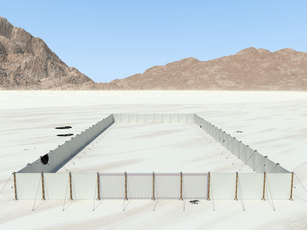

see attached image for reference.
mountain on left has emission set to -.13 and black patches show up, when emmission set to 0 or greater no patches
changing max_trace or any radiosity settings has no effect
setting no_radiosity on mountain fixed problem as a temp fix

Paul commented on Friday, 19 April 2013, 08:17 GMT
to duplicate issue, remove no_radiosity from sinai macro... sorry

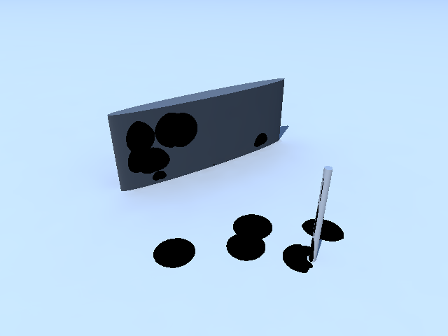

#ifndef(Cam_pos) #declare Cam_pos = 0; #end
#ifndef(Cam_lkt) #declare Cam_lkt = 0; #end
#ifndef(Cam_agl) #declare Cam_agl = 0; #end
thanks for the quick reply Christoph. Just too much to include to duplicate the image submitted so I'll duplicate the issuse with a simple scene and repost later today.
Paul commented on Friday, 19 April 2013, 22:24 GMT
brilliance < 1.4 or emission > = 0 on first cylinder does not seem to duplicate the effect.
any exponent < = 1 in second cylinder does not seem to duplicate the effect.
multiple renders show black circles show up in random locations and sometimes do not show
povray.ini set to default at install
rendered at 640x480 no AA
global_settings {
  radiosity {
   pretrace_start .1
   pretrace_end .01
   error_bound .3
   recursion_limit 1
light_source{
  500*y
  1
  rotate <-28, 0, 14>
camera {
  location <0, 7, -7>
  look_at <0, 3, 0>
background { rgb <.3, .5, .8> }
plane { y,0 pigment { rgb <1, 1, 1> } }
cylinder { <-1, 0, 0>, <-1, 3, 0>, .4 scale <1, 1, 10> rotate 55*y translate 5*z
 texture {
  pigment{ rgb .7 }
  finish{
   emission -.15
   brilliance 2
cylinder { <2.5, 0, 0>, <2.5, 3, 0>, .1
 texture {
  pigment { rgb .7 }
  finish {
   reflection {
    .2
    exponent 1.1
Admin
Christoph Lipka commented on Saturday, 20 April 2013, 14:25 GMT
The problem is not limited to radiosity, nor to negative emissions, as can be demonstrated with the following scene; there is a general problem when anything with a negative brightness is reflected in a surface with almost any exponent other than 1, causing the resulting image regions to be pitch black even if other properties of the reflecting surface would normally boost its brightness back to positive values:
light_source{
  500*y
  rgb 1
  rotate <-80, 60, 0>
light_source{
  500*y
  rgb -0.001
  rotate <-80, -60, 0>
camera {
  location <0, 3, -7>
  look_at <0, 1, 0>
plane { y,0 pigment { rgb 1 } finish { reflection { 0.2 exponent 1.1 } } }
cylinder { <0, 0, 0>, <0, 1, 0>, 1
 texture {
  pigment{ rgb 1 }
  finish{
   diffuse 1.0
   ambient 0
   emission 0
exponent values that are the inverse of a natural number (such as 1/2, 1/3, etc.) appear to be safe. I suspect this is an inherent problem of the math involved, rather than an outright bug.
Note that reflection exponents other than 1.0 are anything but realistic; same goes for negative values for emission (although some particularly vivid yet still realistic colours may require individual colour components to be set to negative values, which will lead to similar problems with a non-1 reflection exponent).
