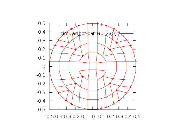

circular area lights exhibit some anisotropy, being brighter along the diagonals than on average, as can be demonstrated with the following scene:

Not surprising, currently the rectangular grid of sample lights is just deformed into a circle, which makes the lights more dense along diagonals (see figure). I see no reason to stick with the rectangular array of lights. The expensive part is testing for shadows, but the sampling lights could be arranged in many ways:

If I'm not mistaken, the density of lights goes as 1/cos(phi)^2 if phi is the polar angle: tan(phi)=y/x, if abs(x)>abs(y), and 1/sin(phi)^2 if abs(x)<abs(y), making the light density at diagonals precisely double than density at the horizontal and vertical line. A "patch" can therefore be done by multiplying each light intensity by
max(x,y)^2/(x^2+y^2)
and normalization of the all the weights, so that the sum of the intensities is still the same as expected.
However, I'm not entirely sure about this, it's a quick calculation.

Fixing the formula would be very difficult, if not practically impossible. It probably won't be just simple trigonometry (I had a similar problem before, it wasn't pretty). To make the density uniform, points have to rearrange in both dimensions (lights from the diagonals have to be pushed apart sideways and radialy at the same time), and finding a useful analytical formula is probably not worth the effort.
