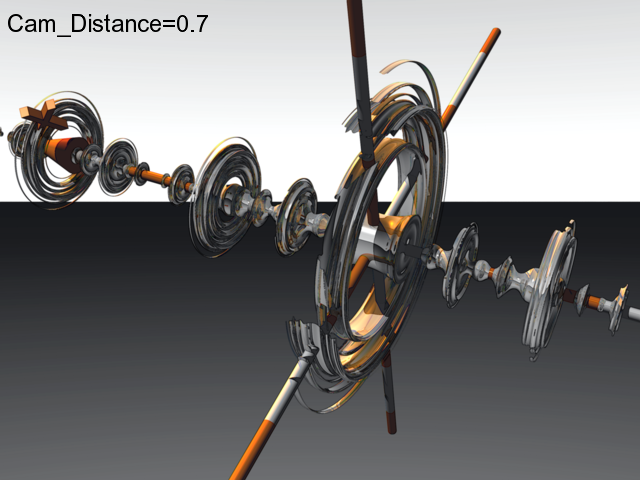

#version 3.7; #include "functions.inc" global_settings { assumed_gamma 2.2 } #declare cam_distance = 0.7; camera { angle 45 location <10, .5, 0> * cam_distance look_at <0, 0, -.5> right x*640/400 rotate <0,-5,0> } light_source { 0 color rgb 1 spotlight translate <80, 80, -40> point_at 0 } light_source { 0 color rgb <2,1,0> translate <-20, 40, -20> } sky_sphere { pigment { gradient -y }} julia_fractal{ <-1.483,0,-0.0,-0.025> quaternion sqr max_iteration 12 precision 500 texture{ pigment{ color rgb 0.7} finish { phong .6 reflection {.6 metallic }} } scale 3 rotate <0,110,-45> }Please notice: with 0.5 as cam_distance, the camera is inside the bounding box of the fractal

Yeah, if you copy the Axis_ and AxisXYZ macros from one of the the Basic_Scene_M... files and modify the POV file like this:
union { julia_fractal{ <-1.483,0,-0.0,-0.025> ... } object{ AxisXYZ( 3.5, 3.5, 3.5, Texture_A_Dark, Texture_A_Light)} rotate <0,110,-45> }you can see that the object itself only extends to ~1.5 units in the y- and z- directions. Also the axes themselves (i.e. the cylinders that are drawn to represent them) are not clipped, only the object. (image attached)

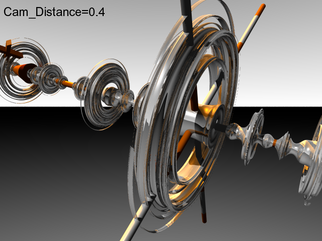

HOWEVER this cannot really be clipping of the object by the camera plane, (at least not the way I understand clipping) since the rings *close* when you move the camera closer. I.e. there is 'clipping' when the camera is moved away from the object (larger cam_distance) but it goes away when I move the camera closer in. Moving the camera ten times farther and making the angle ten times closer does NOT resolve this.
If anything, apparently I need to move the camera even closer in to prevent this.
At cam_distance=0.4 (and angle=60) the object looks like I would expect a Julia set to look like, at cam_distance=0.5 the outer ring starts breaking up and at cam_distance=0.7 (and angle=45) it is wide open. (other image attached for comparison)
