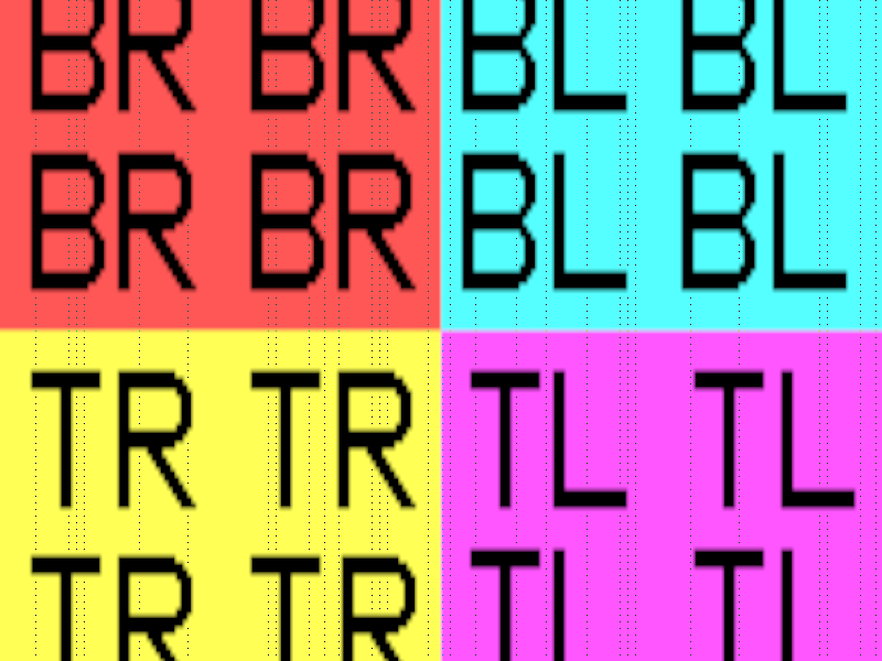

FS#191 - Using interpolated image_maps in functions results in pixel-sized dot-artifacts
Using interpolated image_maps in functions results in pixel-sized dot-artifacts when using the functions back into pigments.
This problem doesn’t shows using the same code on POV-Ray 3.6.
I qualified it as “low severity” because is not going to happen to most users: it will show only when using some advances techniques, for example when you want to decompose an image_map into the RGB components, perform operations, and mixing them back with an averaged pigment (example attached).

Grimbert Jérôme commented on Monday, 07 February 2011, 15:32 GMT

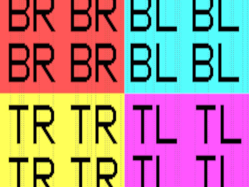

I tested it with 3.7RC3 on linux: the issue is more visible without AA.
Could it be some clipping of the function value done differently (with round error in the process) ?
For instance, a function might value in theorie between 0 and 1.0; but it happens in fact (due to artefact of numerical calculus, so not for a pure mathematician), than it evolves between -0.000001 and 1.0001 (I have seen such result, such as computing the dot product of two unit vectors... it should stay below (or equal to) 1, but requesting the arcos of it sometime generate error (it was bigger than 1.)
Could the artefact be due to the rollover of the value ? (like with modulo (%))
Admin
Christoph Lipka commented on Monday, 07 February 2011, 17:06 GMT
This is indeed what is happening; it’s a precision problem in the interpolation code.
Admin
Christoph Lipka commented on Monday, 07 February 2011, 23:54 GMT
Looks like I introduced the issue with change #4962; color computation in Interp() was done with double precision before, so I'll re-establish that.
Admin
Christoph Lipka commented on Tuesday, 08 February 2011, 19:33 GMT
Done. See change #5400.
Grimbert Jérôme commented on Wednesday, 09 February 2011, 18:52 GMT
Tested: Artefact gone. Seems solved with #5400.
