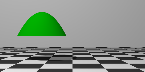

The following paraboloid renders correctly:
intersection { quadric { <1, 0, 1>, <0, 0, 0>, <0, 1, 0>, -1 } cylinder { 0, y, 1 } }
However, when I extend the clipping cylinder downward:
intersection { quadric { <1, 0, 1>, <0, 0, 0>, <0, 1, 0>, -1 } cylinder { -y, y, 1 } }
the object disappears completely in POV-Ray 3.7 and 3.7.1. In POV-Ray
3.6.1, it renders as expected.
POV-Ray 3.7.0.unofficial (self-compiled with g++ 4.8, but completely unaltered)
POV-Ray 3.7.1-alpha.8150025.unofficial
openSUSE 13.2 GNU/Linux
This scene file illustrates the problem:
// +w480 +h240 #version 3.6; //[sic] global_settings { assumed_gamma 1 } camera { location <0, 1, -7.5958> look_at <0, 1, 0> right 2 * x up y angle 43.1038 } #default { finish { diffuse 0.6 ambient rgb 0.15618 } } light_source { <-4.3125, 9.6250, -7.4695>, rgb 6856.3 fade_power 2 fade_distance 0.10417 spotlight point_at <0, 1, 0> radius 45 falloff 90 } box { -<9, 11, 9>, <9, 11, 9> pigment { rgb 1 } } plane { y, 0 pigment { checker rgb 0.05 rgb 1 } } intersection { quadric { <1, 0, 1>, <0, 0, 0>, <0, 1, 0>, -1 } cylinder { 0, y, 1 } pigment { green 0.5 } translate <-1.25, 1, 0> } intersection { quadric { <1, 0, 1>, <0, 0, 0>, <0, 1, 0>, -1 } cylinder { -y, y, 1 } pigment { green 0.5 } translate <1.25, 1, 0> }
On the right side, there should have been a cylinder capped with a paraboloid. A thread has been started in povray.bugreports. Jerome has started to look at it.
